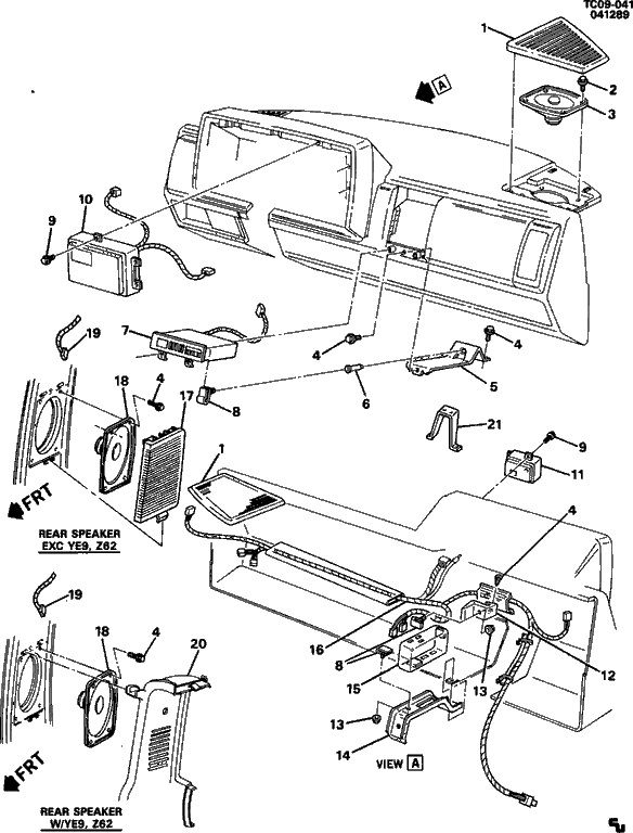

i don't know where the audio system grounds at... or where it gets its power from..  yet..

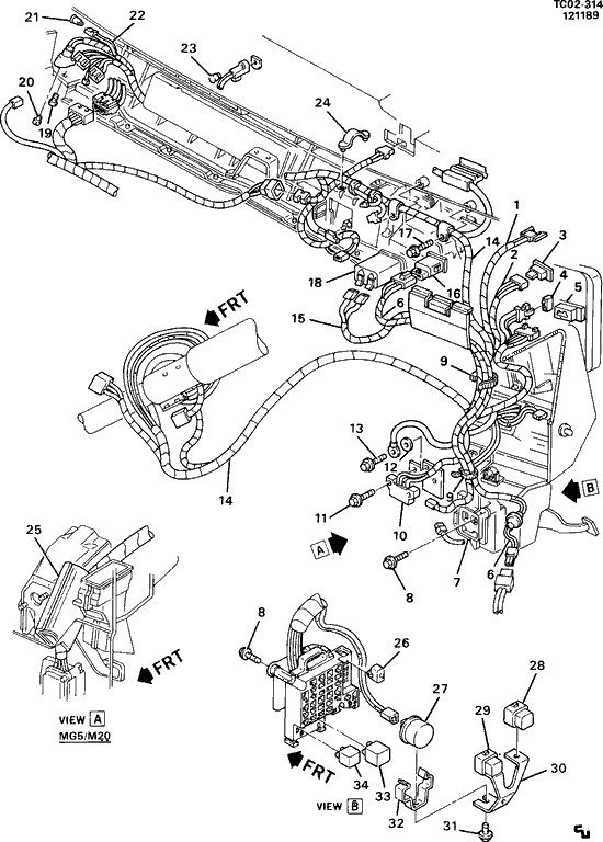

the instrument  cluster grounds where bolt #13 is shown below... i cannot identify the Exact location of where that is under the drivers end of the dashboard..
1990Chevyc1500clusterharness Zpsb5dfd957
if you have a bad ground.. you will have popping.. as the electrons flow from Negative to positive...  the intermittent electron inrush will effect your audio system.. in weird ways..
