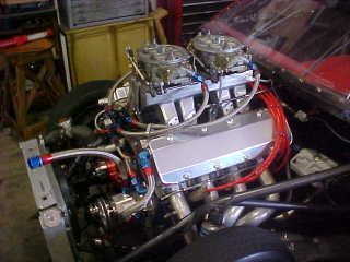

Here is a picture of one of my almost stock motors and the 2500:
MVC 025S 1MVC 023S 1
