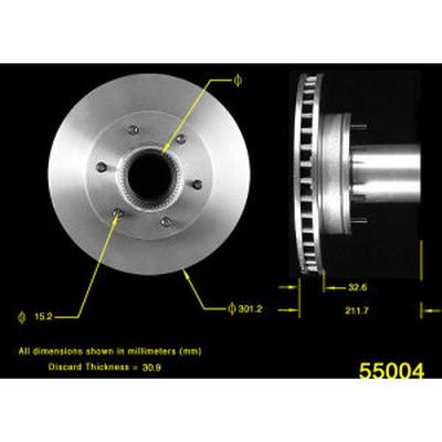

with the K10 rotors and hub looking like this..
0900C1528004c6c4
the bearing races drive out from the closest end..
i have been doing this a LONG time and have worn out all my brass punches over the decades..
i have started using long tapered punches with flat tips like the one on the right side to drive the races out ... a little on the left.. a little on the right.. left and right back and forth as the race slides out straight...
