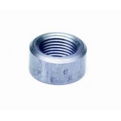

almost every muffler shop will have oxygen sensor bungs they can weld in quickly.. and cheeply.
you can install the air fuel ratio gauge in a temporary bracket and wire it with a lighter plug.. so you can remove it easily..
