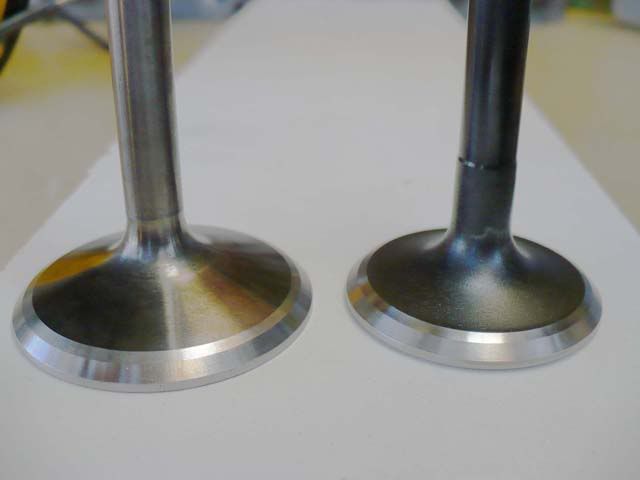

Posted: 02/22/13 03:33 PM
Valves, back cut 30 degrees
P1030092

Tuff,
Thank you for the pics. Like a thousand words.
