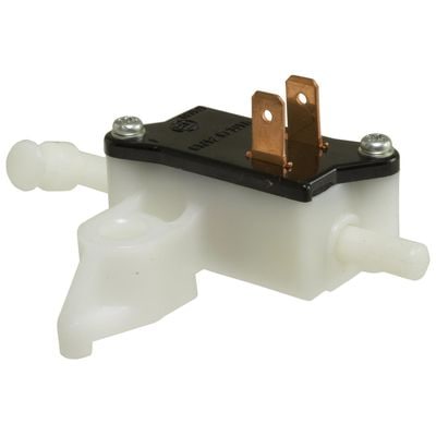

this might help also...
0900C152800627e2
i know this is going to HELP>.
0900C1528006284c

Wayne you are absolutely correct:
This one a tech got had a cruise control that was aftermarket, and it never worked right. I don't know what the problem was. It hit the steel work bench...LOL... It had no brake lights. There was a company that does all kinds of installs.
 I think it was a vacuum switch. The tech at the dealership got it to work. It had brake lights also
 What Japenese company made them?
