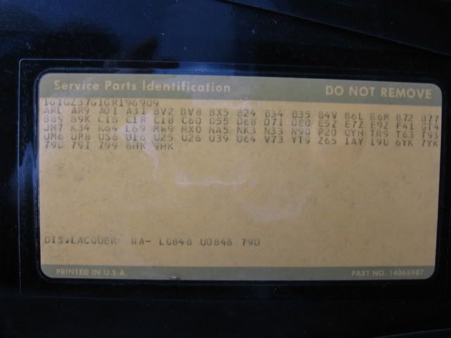

I should have asked you this awhile ago. I have a 1986 Mote Carlo SS with 55,000 miles I'm the original owner no smoking always garage kept never seen snow.
My question do you know if GM played with water based paint in 86.the paint spider webbed or shrunk,only on the trunk and top of one fender,its always had one of those california breathable covers on it..Its the weirdest thing its not on the roof or hood. I bought my wife a 1981 Camaro Z28 that did a similar thing so for them to match the paint the stripped the paint, and I asked the guy at the body shop whythe paint would have cracked like that, she only drove it to work and then it went in the garage,he said something about GM using water based paint back in 1982 when they repainted the whole car,the guys that did it you would never know it was repainted.I have done my share of painting on my race cars,

This is the RPO code/paint code sticker inside the trunklid of my friend's old black '86 SS Monte Carlo. As you can see in the bottom left corner of the sticker, it says "DIS LACQUER". So I'd say your car has dispersion lacquer on it. Thats where they put an electrical charge on the body and fog a mist of paint into the whole booth, then the paint is drawn to the metal by the charge (like "e-coat" primer. This one is black and also has a clearcoat.
IMG 0257
Lacquer cracks, always eventually. Refinish industry professionals will tell you that something like 85% of new cars have had paint repairs before ever reaching a dealer. So your car may have been spot-repaired by GM! Many were. It can be near impossible to tell, but sometimes its obvious. Like under wierd parking lot lights, where metamerism comes into play and the same color looks different under different light.
When GM started the "peeler" phase was a couple years later, remember when the new trucks came out in '88? I had a painter buddy who made over a hundred grand one year razor blading the paint off Suburbans and repainting them under warranty. Those are your early factory waterborne paint jobs, and they missed the mark. Color didn't stick. Refinish paint stuck fine to the primer underneath though.
I think the dispersion lacquer is solvent based so it probably won't peel, but being lacquer, its gonna crack with age. If you ever wanted to stop the cracking, you'd have to go down to metal or at least the bottom layer of primer to get past the uncatalyzed coatings. Just keep taking good care of it, and repaint what you can't stand to look at.

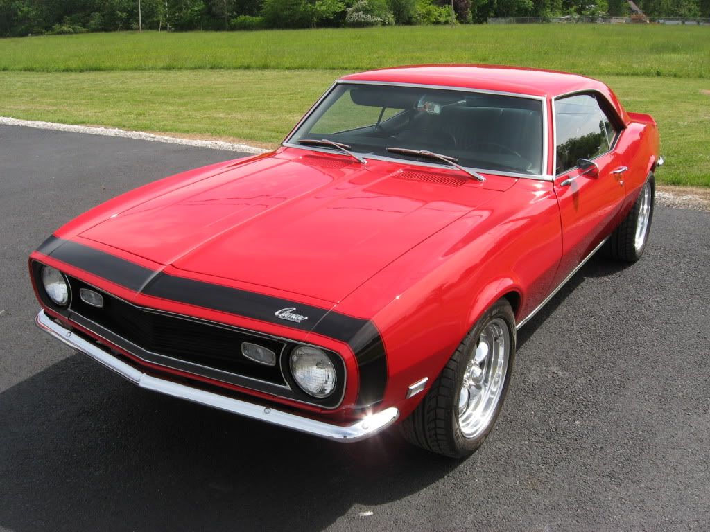

Heres a Chevy with nice paint for y'all. I still take pics of the nice stuff!  Cool Shot this photo yesterday.

you do some awesome work Matt.  thats a beautiful paint job.

I never gave that a thought.As being spot repaired:This happened years after we bought it..I'll bet at least 10 years after so the Lacquer paint makes sense.

Well Joe I never laid a finger on that red Camaro. It just came in to get some tire clearance issues fixed and I don't know what else. We may have painted it or not, in the past. It got some elbow grease before we parked it outside though, and that shows. The pic just turned out nice and it was a red Chevy. How the hell you and the boys been, anyway? Y'all rip any fresh driveway stripes lately?
Bob, yep lacquer sucks for a painter, tries to melt when you dry sand it. Factory defects? I climbed on top of a brand new un-sold Yukon about ten years ago and found a clump of primer  (like the robot gun spit it up) about a half inch tall, right out in the middle of the roof! It was under the paint and looked like a bubble but it was solid. We at the dealer fixed and painted that after the PDI, before the sale and under warranty. As you mentioned, GM isn't known for stellar paint jobs, although they have made some great colors over the years. I'll hafta look up that movie.

   thats not a bad idea but Matt and I live at other  ends of the of the Country....But when he said that about touch up it made sense.I remeber the build sheet in the truck and at the bottom it has that Dis. Lacquer. and I guess the WA is the color Maroon... Cool

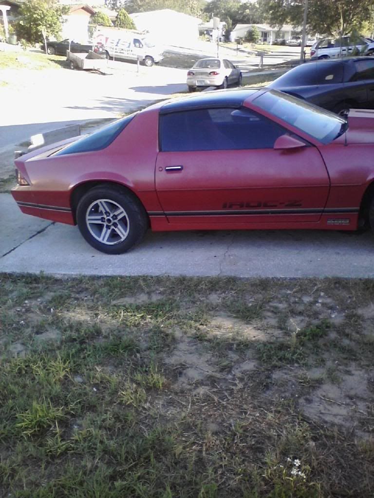

im still plugging along on our iroc.   i finaly got the mickey thompson drag radials mounted a few days ago.   man, they made a HUGE difference in traction.  i love em.   i want to add a few safety pieces to the car like a driveshaft safety loop and some better rear studs.  i got a great deal on a new fiberglass cowl hood.  i just gotta go pick it up.   my son Jo-jo got 13 stitches in his neck the other day.  he got cut by a grinder somehow.  hes a trooper though, he went right back to work.
  i hope everything is going great for you Matt, and everybody else.
  whats everybody else working on?
