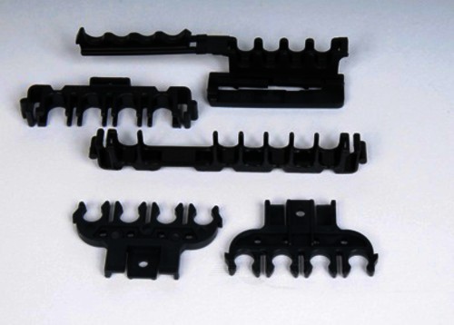

see if you can find this in delco someplace.. it should be the proper wire separator set..
RETAINER KIT,SPLG WIRE
ac delco Part Number:  8073
Product Notes:
Spark Plug Wire Retainer
Per Vehicle: 1; Years: 1989-1992
8073 Primary
this looks like its missing a bottom piece... so it might not be what you want.. just separate the wires.. like ford did it...   5, 1, 3, 7 ..
