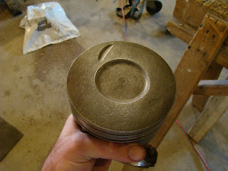

Ok back to the 454,,,,,,,,,,I started with cleaning the block and blowing it down with air. Followed with the pistons and crankshaft
as you can see the original pistons cleaned up well and are in great shape

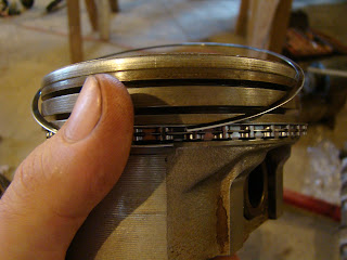

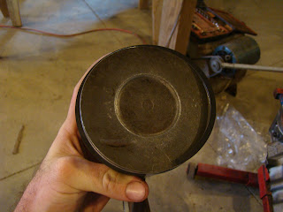

I used an old ring and broke it in half to clean all the carbon out of the ring grooves
DSC03621

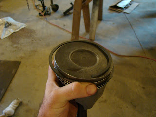

here is the pistons cleaned and ready to be installed

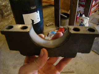

then install a bearing in the main cap insuring its fully seated
DSC03628

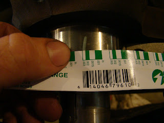

then install and torque it down, then remove  it and use the scale on the package to see what clearance you have
DSC03629
mine came in at .003 which is normal, repeat for the rest of the main bearings, being sure to clean the residue from the surfaces.

Hey great thread the pics are great for newbies like myself. How would you suggest cleaning my pistons? I've got a ton of carbon caked on there. Can I soak them or something?
Posted: 09/26/11 08:58 AM
Carb cleaner and gentle scraping works great.

Yes soak them in a bucket with some diesel fuel or degreaser over night either works great and the pistons will come out nice and clean.

I use a Stainless Steel Borillo pot scrubber to rub the loose carbon off.,. it works great.

lets ring the pistons,,  I like to install the rings by hand only by just spiriling the rings into the grooves
start with the oil spacer ring then the oil rings:

these particular rings have dots, so dots face the top of the piston
DSC03635

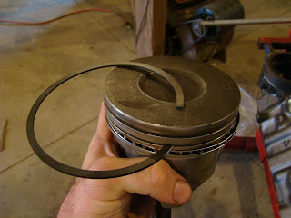

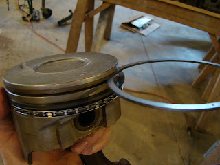

then I like to just catch one end of the ring into the groove, then just slide it around carefully, DO NOT FORCE ANY OF THE RINGS, if there is a problem stop and try again. otherwise they will snap!
DSC03636
DSC03637
Then the same procedure with the top ring:
DSC03639
DSC03640
