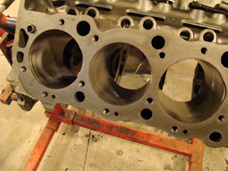

the block:
DSC03589
the original bores were in great shape,,, so I did not have it bored. If it dont need it its a waste of money.
I had the machine shop, vat, install cam bearings and freeze plugs, and hone it. for a cost of $130 that did not include the parts.
DSC03590

yeah there is a slight ring at the top of the bores, but you cant hardly detect with  a finger.  upon inspection I decided to go with it considering the compression and power level of this engine

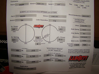

yes I did get the new valve springs recommended for the cam, they are 120# on the seat and 350# open.  I didnt get crazy with the springs simply cause I didnt need them for this application  However I will add that If I was gonna push this engine past 5500 RPM I would go with stronger springs,, big blocks have much bigger heavier valves and just need more spring. If you add high compression and or forced induction it just goes up from there.
