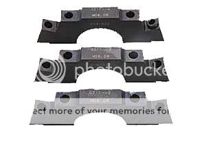

1) Get a 2 bolt 400 block and have splayed 4 bolt main caps installed with ARP bolts., Eagle and Coleman makes them, among others. The Eagle main caps are a good plan too, for only $70 and they come with a drill pilot.
Eagle4boltmaincaps356 C4103S

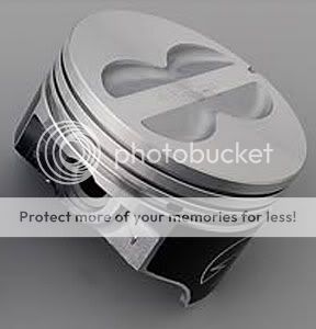

5) KB 400 flat top claimer pistons or Speed Pro with 4 valve reliefs will work, but you have to remove about .040" from the piston crown, by machining (turning) on a lathe. These pistons are for the 5.7" rod (the ones you want) and come in +.030, +.040 and +.060 oversize.,. Speed Pro 844-H616CP30, 844-H616CP40, 844-H616CP60 and for compression issues, the dished ZH601P30 will work, since .040" gets removed from the crown.,. leaving a slight dish.
This is simple enough of a job, for a "good" machine shop.
Speedpro844 H616CP40
Here is the math.,. to arrive at .013" compression height with this combo.
The 400 KB pistons are for a 5.7" rod and a 3.75" stroke.,. this build uses 6" rods that are .300" longer.
Now our shorter 3.25" stroke is .500" (1/2") shy of the 400 stroke 3.75".,. but we need to divide this in half, because .250" is at TDC and .250" is at BDC, for a total of .500"
So if we take the .300" of the longer rod and deduct .250" or half the stroke difference.,. there is .050" to deal with.
But, there is a .023" OEM compression height (piston crown sits below deck surface) and we are going to reduce that to .013".,. by only removing .040" from the piston crown.
Now if we take the .013" compression height, and add .040" for the gasket, the squish band becomes a nice .053" +/- a few thou.

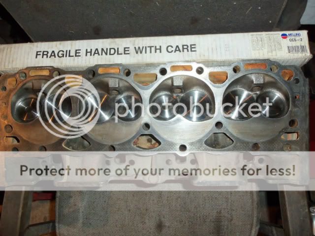

6) Use a set of Vortec heads and go with 2.02"/1.5" valves because 2.06"/1.60" will not fit in a stock 64cc chamber head and for class rules there is no porting permitted.
Vortecchamber
All done, 2.02" Intake and 1.5" exhaust in the 906 heads
Vortec906with202s

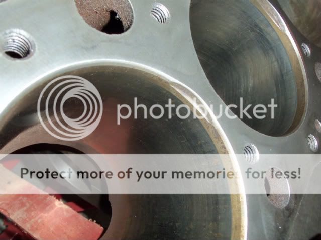

Almost forgot to mention.,. the block needs to "scalloped" to clear/unshroud the big 2.08" intakes!
Bbcylinderscallops
