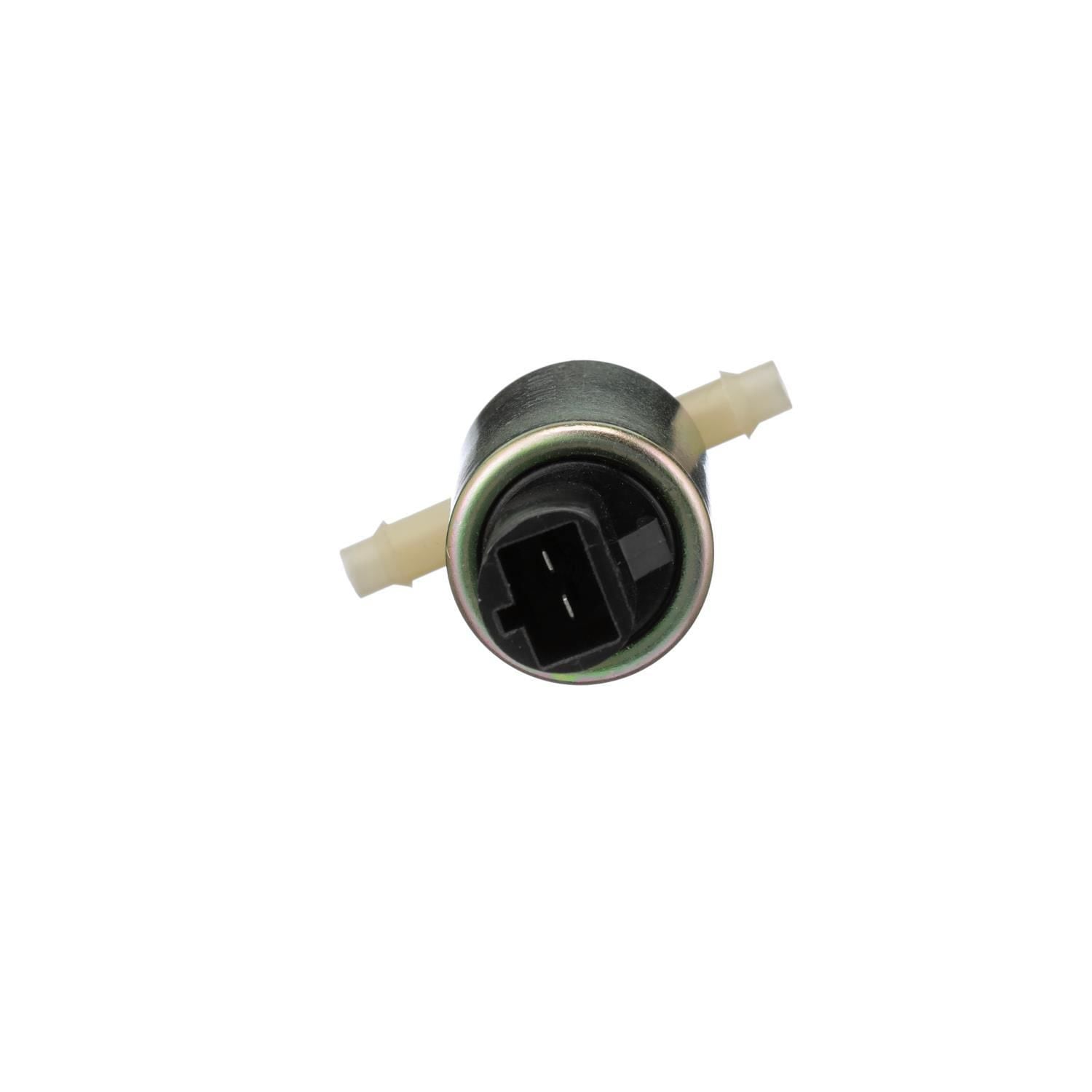

the carbon canister also kind of required 2 ports on the carb..    a purge port..  something OTHER than the PCV hook up .. unless you want to install a solenoid valve.. to prevent the fuel vapors from collecting in the crank case..   and you can still use the double fitting PCV for the purge connection..
this can be vacuum operated to shut off flow unless there is ported vacuum applied..
there are just so many ways to go but the carbon canister also prevents liquid fuel from being pulled directly into the carb..  only vapors get through..
