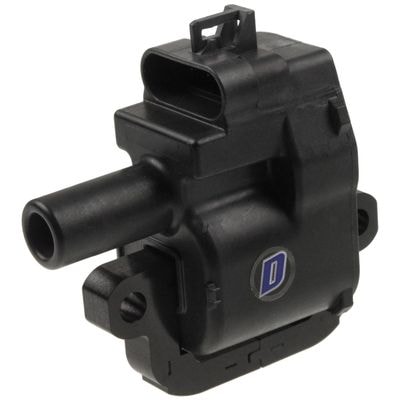

this is what the ignition coils look like...
i would take the coils off and examine them one at a time.....  look for signs of high voltage leakage...  dust circles between the inner winding and the inside of the outer frame....

i have in a pinch removed the coils and  cleaned them with brake cleaner... then forced silicone sealer.. usually ultra grey .. between the gap ... adding to the insulation...
the other problem is coil internal failure...  this is going to be a LOT easier with an under 10 buck tool at most parts stores...  part number 25069 at many parts stores
25069Sparktester
you can just use a screw driver.. or a modified spark plug. but this is adjustable...  so you can.. when its NOT sparking . . open the gap by twisting the screw ... then having somebody crank it again...   try not to run it for long with the wire disconnected...  these tests are usually done with the fuel pump fuse out.. and the injector power undone... usually by disconnecting the main injector connector..
you have to have a bright blue snappy spark.. that will jump about 3/4"    if you only get an orange spark and it will only jump a 1/4" .. you have a bad coil....
