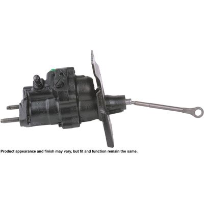

what am i thinking....  hydroboost was used on hundreds of thousand chevy and gmc trucks...   so its a bolt on for you...
here is the 87 3/4 ton hydroboost unit with the 6.2 motors..
1987 Chevrolet Truck R20 3/4 ton P/U 2WD 6.2L Diesel 8cyl
