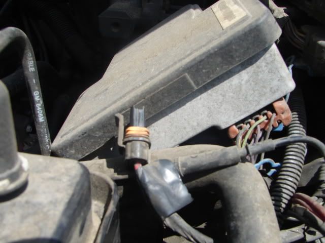

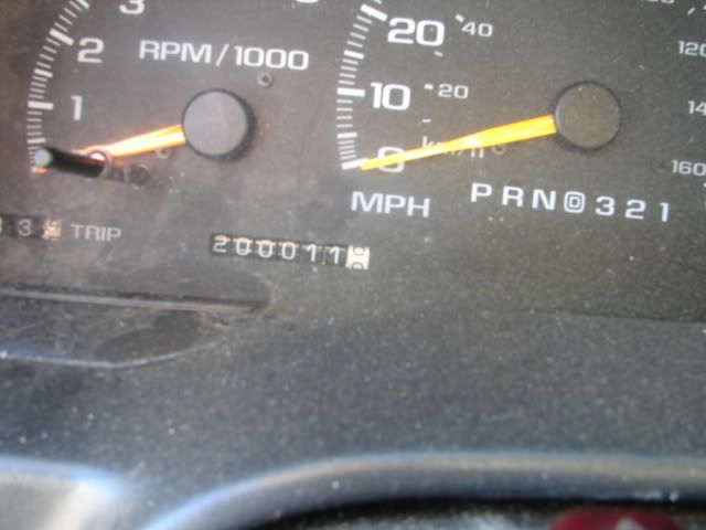

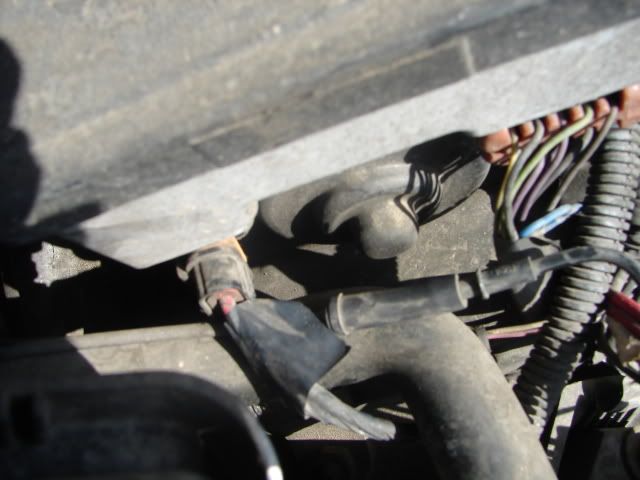

Anti-lock does not work, truck at low speed has slid through an intersection on a panic stop, and brakes have faded and not stopped other times. I drive it like I'm towing when I'm not towing to avoid panic stops. Brakes seem to be working better. Brakes make a grinding noise when brakes are not applied but noise goes away when brake are applied. Noise is coming from brakes not releasing completely and eventually you can smell the brakes and see the heat off of them. Before I got it brakes were done 6 months before and 3 months previous. Then I did the brakes and were replaced and lasted 2 months. Brakes were replaced again and bled and flushed brake fluid and have lasted 3 months so far. Right now with it disconnected it stops better, less fade and fronts lock up on dirt road in panic stop.
1/2 ton five lug light weight truck is all stock
DSC04421
ABS light on all the time but now it's off since unplugged
DSC04792
Unplug from here-
DSC04876
DSC04871
DSC04874

sounds like your calipers are "sticking".  once they get hot,...your gonna have a soft pedal & that burnt smell.  have you tried replacing the calipers?   dot 4 or 5 brake fluid may help with the boiling point of your fluid, but i'd make sure it's compatable first.

if the ABS light is ON constantly.. there is a problem with the ABS...
the abs light should ONLY be  on during the bulb check when starting .. and when you have your foot planted hard on the brakes in a panic stop....
log in check PM.. i will post my contact info there..
but i don't have a scan tool that will talk to the antilocks .. and when the system is unplugged  ..  it looses any codes...
it takes a decent scan tool.. almost any  of the newer ones with a color screen.  or a tech 2...  to really examine the antilocks...
i should be able to extract codes somehow..   we will see ...  i will have to whip out my HF and OTC scanners.. see what  i can find....
