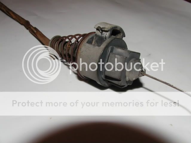

Posted: 05/23/11 09:00 AM
It's real simple to adjust the cable.,. lift UP on the lock sleeve (top of pic) open the throttle all the way.,. push sleeve down to lock.,. let go of throttle.,. done.
Piece of cake.
