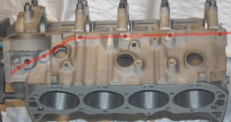

oil flow after it comes out the filter.. some goes up to the lifter galleys.. some goes down the galley in the side of the block to the main and rod bearings. but also to the forward 4 cam bearings..
the rear cam bearing and lifter galleys are oiled in the conventional manor up the rear and forward..  you will have to study the bottom image carefully.
BBC Sideoilgalley Zps1ea35d93
you can see in this gen V block that there are 2 oil pressure relief valves..
you can easily see one. but look down the center hole under the filter..
Bbc Geniv Oilbypassvalves Zps6a63a959
BBC Oiling Zps83f2d446
