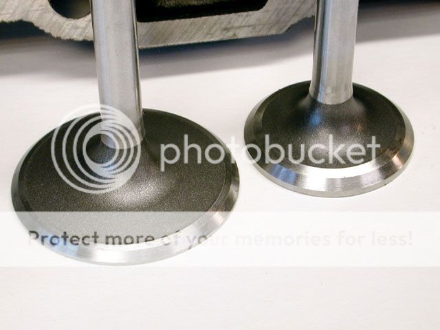

When your machine shop does the valves, have them back cut 30 degreesValveswith30degreebackcut Zps8c884e12

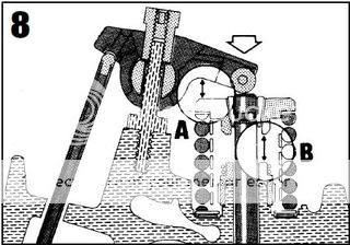

I would insist on screw in rocker studs and as far as springs and retainers go, I'd also do it right and machine the guides for the larger springs. You need to keep a close eye on rocker/retainer clearance.
Rockerretainerclearance 1
as well as rocker geometry
Rockergeometry 2

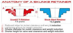

Your machinist has to evaluate all the critical clearances with his "trick" springs and retainers.
Retainers 1
Retainerandspring 1
