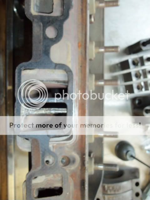

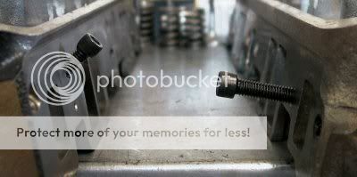

dond got me over here from another site and your casting #'s indicate that the heads are 305 Vortec with either 58cc or 64cc chambers.,.
These 305 vortec heads are similar to the 350 L-31 heads but not quite the same. They are not like the older center bolt "swirl port heads" either.
They have a combustion chamber that is more like the L98 TPI heads 081 and 083 cast iron. The ports are similar to the 350 vortec heads. They use the same manifold bolt pattern and raised intake port position. The stock valve size is 1.84"x 1.50".
The combustion chamber size is supposed to be 58cc but may very well actually be 64cc.
If you don't mind reworking these heads a bit and can get them done fairly cheap, they can be a very good deal.
They will need larger 350 sized 1.94" intake and 1.6" exhaust valves. they will also require a bit of porting and some chamber rework to unshroud the larger intake valve around the chamber wall, thus taking advantage of the large valves.,. they will also need all the valvetrain machining that the 350 vortec heads need, to run any kind of high performance.,. the stock vortec maxes out at .460" lift.,. because the stem seal sits on top of the valve guide.,. retainer and seal interference is to be avoided, with anymore lift.,. machining remedies the max lift issue beyond .500" lift.
They have a lot of potential, by virtue of their fast burn chamber.
Hope this helps.
