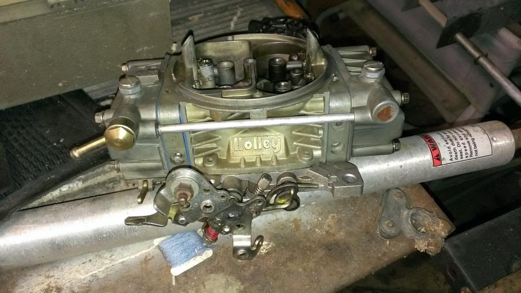

i bought a trk the previous owner converted it from tbi to aluminum intake , spacer and a non chocked holley 8105B carburetor, its running rich, way rich, can somebody tell me how many cfm this thing is, i would like to know before i spend to much time messing with it ( i believe the power valve is bad) im not a big fan of holleys, i think it is just way to big for the trk, it appears to be a stock 350

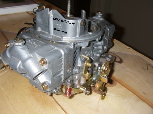

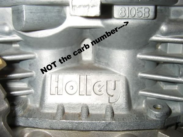

the LIST number is stamped on the front of the air horn..

no choke horn, already did the idle screw thing, took out power valve, sprayed it with carb cleaner, twisted it back and forth a smidge, put it together, and it ran better for a few minutes and then started riching up again, im going to get a power valve today ( 8 bucks), my biggest concern was how many cfm it is, its a chevy 3500 with a utility body, i dont think, high performance tuning is going make it go much faster  Confused

QUESTION How do I find the "list" number on my carburetor?
ANSWER The list number for most performance and factory 2 and 4 barrel carburetors will be found stamped into the upper right hand corner of the airhorn or sometimes called the choke tower.
On the 4150 HP models that do not have a choke tower the list number will be stamped into the mainbody behind the throttle linkage. This number is used to identify the carburetor and also used when needing service parts or renew kits.
but they make a whole bunch of different versions..

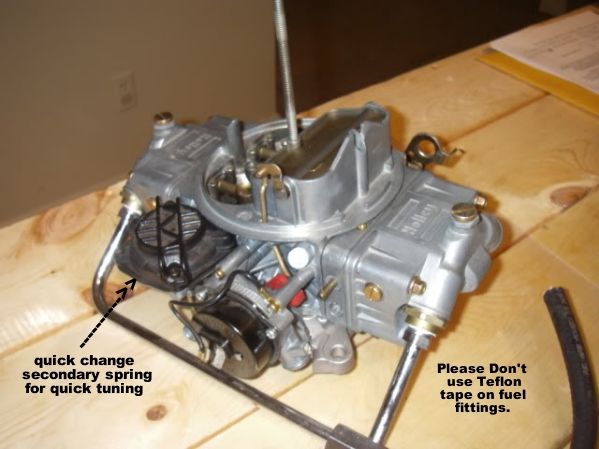

i am taking that it looks like this one..

here r pics of carb    http://s1273.photobucket.com/user/saltlife49/media/IMAG0306_zps65149c69.jpg.html?filters[user]=134582003&filters[recent]=1&sort=1&o=1
