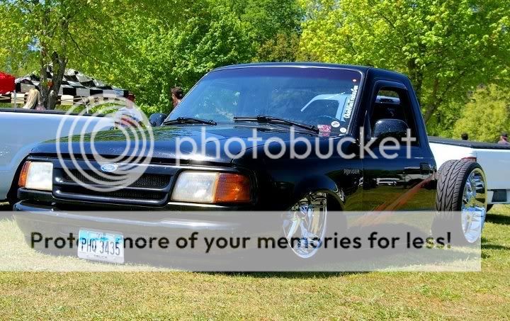

Ok, I have a bagged and body dropped 94 Ranger. It looks like this
I build a chassis for it, it has the front suspension clip or a 1994 s10, firewall back custom frame, custom core support, s10 10bolt rear end.... etc. I have the brake booster behind the cab right now but I'm gunna relocate it behind the dash so I can remote mount the turbos Behring the cab (one on each side)
I have a.355 at home, it has Dove roller rockers, solid lift Cam, haven't been into it in a log time so I can't remember what else but I am aware that I have to go through the entire more before I do this.
I'm just curious as if I can run 2 70 trim turbos mounted that far.from the motor. I've been told ill get Turbo surge.
I also want to know the way to limit the boost I'm putting to the motored between the two turbos(I only want to run 10-14 psi total)
and I think I'm going to go with a TPI injection system.
By the way everyone the help is much appreciated. I am 21 and have learned all this stuff in the garage, am I off to a good start? And 1 more thing yes I know its a ranger hut it was my very first vehicle Built for Touche with Chevy stuff!
